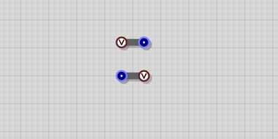

I'd like to know the specs of version 3.0.9 Beta2 (I'm still using V 3.0.6).
Is there some primitives of "DOUBLE stream to frame" & "frame to DOUBLE stream"?
I read the version history. It says "IMPROVEMENTS: New Double Stream connector type".

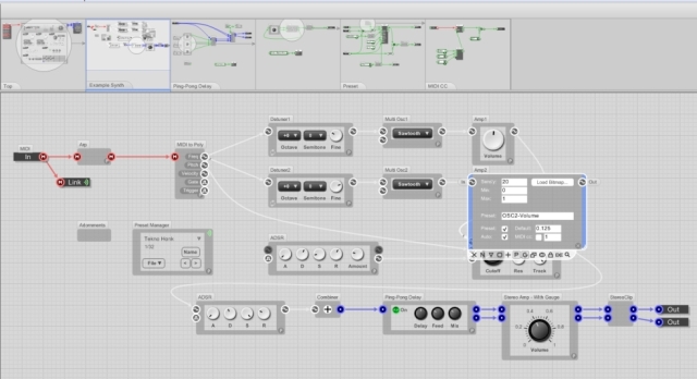

Hello FlowStone Community,
Thanks a lot for all the activities and information about Flowstone and the chance to create VST-applications.
I've been waiting a long time for MouseWheel support
By testing the Beta2 of Version 3.0.9. noticed the following issue:
When I try to activate the MIDI CC (checkbox in the properties menue) of a control knob in the Example Synth of Flowstone the whole programm crashes.
Due to the reproducable crash I am posting this issue here - I don't have a clue what's the reason for the crash.
Hope you can use this info for improving the Beta. Maybe you can reproduce the failure by yourself. Maybe it's a mistake by my own.
Best regards !
