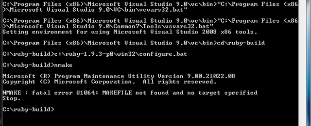

Hi guys
Im trying to follow the tutorial and build the ruby source but i am running into the wall when getting to the make part could someone take a look and tell me in which idiotic way :lol: I am doing things wrong? ive never done this before!
Thanks

== Build examples
* Build on the ruby source directory.
ex.)
ruby source directory: C:\ruby
build directory: C:\ruby
install directory: C:\usr\local
C:
cd \ruby
win32\configure --prefix=/usr/local
nmake
nmake test
nmake install
