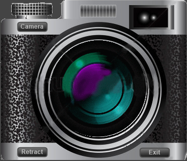

A Photo of a CAMERA with SHUTTER LENSE and FLASHLIGHT as well as a PHOTOGRAPH that slide out when the Camera is activated. The shutter really opens and expose the lense and then close again whilst the flashlight also flashes. I completed this project last night as a fun thing, just to show the many interesting possibilities with Flowstone. Unfortunately due to its size, it is not possible to upload the schematic and my dropbox is still overloaded with internet traffic and therefore temporarily disabled.
- Camera with Shutter Lense & Flash.png (145.43 KiB) Viewed 32294 times
