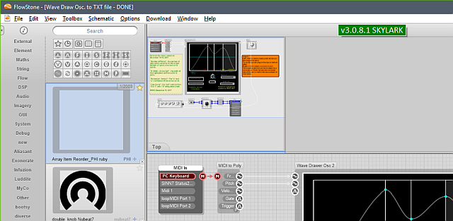

That schematic was saved with a newer beta version of FS!
It's just a buggy error message...
I'm working on a tool to see in which Version the FSM was saved and another to show the actual IDE Version on screen.
With a menu to start different Versions incl. beta ones and even automatically set the correct file association...
But had no time to finish it... Hope i find some time for it soon:

Walter Sommerfeld wrote:That schematic was saved with a newer beta version of FS!
ThIs will be a handy addition, I hope you complete it soon.
Those 'error' messages can get kinda kreepy !
