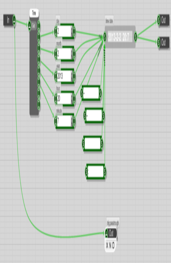

Hi there!
Anyone knows something about the time module not always giving the decimal minutes?
I mean if the time is 17:25 the module gives 17:5 this is not always but it does occur often and on several pc's.
The time is manual asked by push of a trigger
same with FS 3.00 as FS 3.01.
thanks for any help. see pic please.

- resized it, its not ok but you can see
- time-bug.PNG (273.88 KiB) Viewed 12506 times

Time module is fine, your arrangement - not.
Seconds are sent as number (integer), that why you don't get "0", like "01". You need to add some detector, whether number is 1-digt or 2-digts, and depending on result - "0" would be placed before number (keep links order), when sending it to the string.

maybe you're right, i will make a detector if the first digit is of the minutes is 0
edit* ok got it thanks, added a selctor who ads a 0 when the minutes are less then 10
