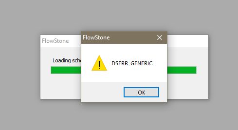

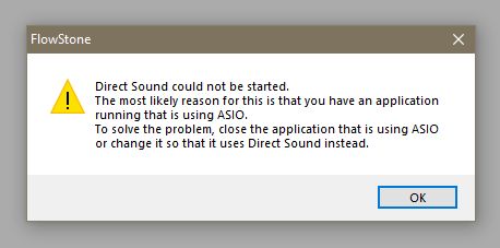

I noticed a microphone icon in the bottom bar, so I clicked on it. Pop up said Flowstone is accessing my microphone, and gave me option of turning it off. After doing so, now I get these popups before a schem opens, then there's no sound.
Getting this with 3.0.6 and FS4.
I can't for the life of me figure out to get that window back to turn the mic back on.
I know, I know I should be using ASIO, but every single schem I've ever made has the DS prim in it; if I can't fix this I'd have to replace it with the ASIO every time I went to work on one.
And I'm not running any apps using ASIO! Why does it think I am?

Go to start menu, settings, select privacy (lock icon).
On that page select microphone on the left. On the microphone page, makes sure, all microphone options for accessing are on. The first is a general access on this device, the other is "allow desktop apps to access your microphone". Underneath that option, you will see a list of apps currently allowed to access the microphone. Flowstone might already be among them, but it needs allowance first.

Regarding the question: Don't take the suggestion as a fact! What happens is the following. To protect you from malicious programs, that could take over the mic for invading privacy purposes, the system asks you for every program that wants to access the mic, if it should be allowed. You say yes, and that's it. But, to notify you of mic access, everytime an icon is displayed on the taskbar (which after some time switches to the hidden symbols tab). This is a protection measure. At any time, you can click the icon to prevent access. Which you did. From now on, when an app tries to utilize the mic, it gets an error code from the system. It's a generic code, and instead of showing you the code, Flowstone tries "to help", by assuming things and suggesting possible help. This message was created by Jorge, long before any microphone privacy settings in the OS existed. Today, such a message would read different. From the description, it should also have become clear, that this ia a protection that works without exception. No different to ASIO. Or any other driver you might want to use. You have to allow access once.
