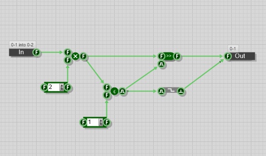

Here's a question for the real coders:
This will stop sending trigger halfway of a knob.
I block triggers this way when I use like... log10 and some "power" operations afterwards, that aren't needed for half knob turn... this seems justified.
But how much green does one really need afterwards to justify this, and the constant overhead of running it?
Log, power, or a whole bunch of divisions maybe?

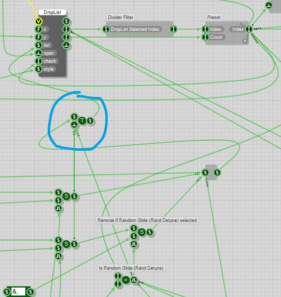

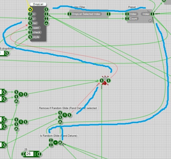

Hmmm...
The Alpha thinks this is a problem, but old FS does not...
So the logic would be that update to the list cases a trigger in the Dropdown prim outputs. But this isn't an issue with old FS?
- R&R
- Posts: 474
Re: Question about green
R&R wrote:The Alpha thinks this is a problem, but old FS does not...
Easily fixed with a S&H... But clearly a difference between FS4 and old FS.

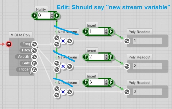

Re: Questions / Things of green
martinvicanek wrote:Here is an alternative (FS User Guide p.219f):
Wonder if Maik has hidden any treats in the Voice-type stream, thats not available...
Hmmm, along those lines... some poly stream values that could be passed along each stream would have been practical. Maybe i'm just unaware if there already is such a thing in FS.
Might have been to costly on the CPU perhaps...
- R&R
- Posts: 474
R&R wrote:Hmmm, along those lines... some poly stream values that could be passed along each stream would have been practical. Maybe i'm just unaware if there already is such a thing in FS.
Not a green question. Breaking my own topic
I'm so slow
Could just sacrifice resources by using more Poly's and filter out by Id, or perhaps by any other arbitrary value I guess...?
Anyone used an "early in schematic bus creation" type of scheme in elaborate more global way in any of your FS plugins?
