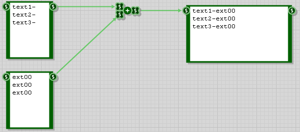

Something is missing in string arrays or I can't find it.
If I have two strings arrays, like that:
text1-
text2-
text3-
and
ext00
ext00
ext00
I'd like to add them as line+line, to get:
text1-ext00
text2-ext00
text3-ext00
But none of these two works that way: "append string array" nor "add" primitive.
How to do it?

Verry simple
Just "add" both array or connect them to the same plug
Regards
Regards

Did the same thing and it did not worked, it added second text field after the first one. But I think I know what was wrong. Forgot that the text primitive is not string I/O. Thanks for reminding.

be shure that it is an array
If you connect 2 strings together the lines of the 2nd one will be afterwards and not addet to each line.
Regards
