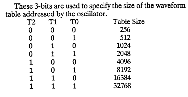

What threw me for a while was that there seems to be an error in the chip documentation. If you have a larger wavetable you have to read it out faster to achieve a given pitch, not slower. They inverted the meaning. My guess is the document writer was not the designer.
Anyway, the WSR value in the spread sheet gives more information than we need in fact.
The lowest 3 bits (0 to 2) are for the resolution value and this is only needed for the DOC hardware to get in the right range for the pitch called for. Bits 6 and 7 are for the ROM address decoder, so again we don’t need them. What we do need is bits 3, 4 and 5. These 3 bits describe the code for table size (5 is the MSB). See the chip spec sheet table below.
The wave ROM is divided into blocks or "pages" of memory. Each page is 256 bytes long. A waveform can be made up of several whole pages concatenated, or can be a minimum of 1 page (256 bytes).
So we take the base address (starting address of the waveform) from the Wave ROM page in the spread sheet. Then we look at the 3 relevant bits (3, 4 and 5) to find the size of the whole waveform table, from the table above. Then we divide this size by 256 to find the number of pages used up. If we then add this value in hex to the base address we get the end of file/start of next wave in the ROM.
I’ve checked this method on several randomly selected entries and it’s always worked. I see that the later ROMs #2 to #4 contain much longer waves so there are fewer available in the memory space.
So, to sum up:
The start sample number for a waveform is the Wave ROM page number x 256 (all in decimal).
The end sample number is the start number + the sample number given by the table, based on the 3 bit code embedded in the WSR value. Of course it’s a zero-based count so the first sample is numbered 0.
Here’s a worked example:
If we look at ROM #2 “bowing 2” the WSR is 74h so the binary is
01110100
which means the length is referenced from xx110xxx and we look up 110 in the table to be a length of 16384 samples which is 16384/256 = 64 pages. In hex this is 40h. The base address of the wave in hex is 40 and, sure enough, the next wave starts at 80h. So this complete waveform starts at sample no. 16384 and ends at sample number 32767 (not 32768 because that’s the start of the next waveform).
I do hope this helps the cause!

First off, everything tulamide found out I agree with completely. I took my own path and came to the same destination.
So, to sum up:
01110100

I don't know how you made sense of the document, but everything you explained makes sense. I'm still not sure if I understand how the spread sheet works, but I guess it's asked too much to give me exactly what you did in the example?
These numbers are, what I would use in the ripping code to extract the waveform. I just guess it, but it is a lot of work to get from the page numbers to these exact sample numbers?
Anyway, that was extremely helpful! It gives me hope to extract those pesky waves soon!
Thank you so much!!!

No probs! It “only” took me about 7 hours of reading, re-reading and analysing the chip data along with the spreadsheet! I did enjoy the challenge.
I’m a bit worried that you didn’t quite get the process for extracting the start and end sample numbers in the ROM image though. It’s not so easy to explain such a thing clearly.
One thing you can leave out is the number of “pages” in use. I talked about that for the detail of how I proved the method worked with the spreadsheet.
I’ll try another tack:
- Convert the Wave ROM page number from hex to decimal. This is the Starting position in the next step:
- Start of desired waveform index (sample 0) = Starting position x 256
- Length of waveform is looked up in the table based on the bits 3, 4 and 5 in the WSR entry. (I used the Windows calculator to convert the WSR value to binary first, so I could see the 3-bit code I wanted)
- End of waveform (final sample) = Start of Waveform index + Length -1
Maybe that helps?
Maybe that helps?
I think you could write a bit of Ruby code where you input the base start value in hex and the WSR value in hex and, provided you have the lookup table involved, it could spit out the actual decimal start and end values for each of the waves.
As an aside, I read a lot of reviews and information about the SQ80 and it comes through that the noise waves are the weak spot for this synth. You will inevitably get a periodicity with such short noise bursts and even the Musician’s Manual hints at this. You could say it’s part of the “character” of the synth.
Please say if you need any more help with this project, and when you get those waves out I’d love to have the files. I quite fancy having a go at an “inspired by” version myself.
Cheers and good luck!
