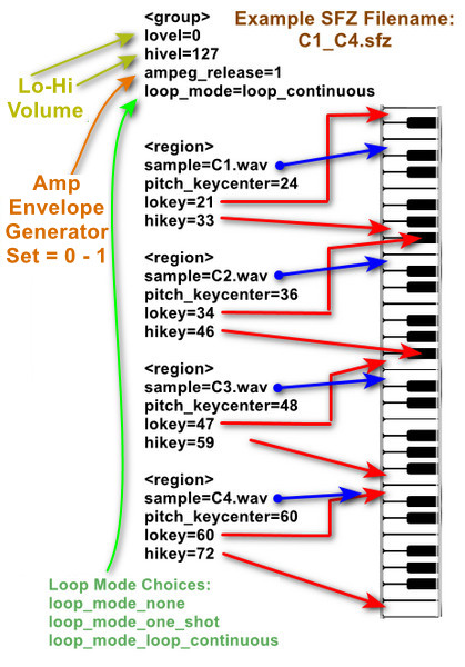

BELOW IS AN EXAMPLE OF AN SFZ FILE WITH FOUR 'REGIONS'
ONE EACH FOR A DESIGNATED FREQUENCY RANGE
SFZ FILE WITH MULTIPLE SAMPLES
FOR MORE ACCURATE FREQUENCY RANGE
FORMANT RESPONSE
EXAMPLE FILENAME: C1_C4.SFZ
<group>
lovel=0
hivel=127
ampeg_release=1
loop_mode=loop_continuous
<region>
sample=C1.wav
pitch_keycenter=24
lokey=21
hikey=33
<region>
sample=C2.wav
pitch_keycenter=36
lokey=34
hikey=46
<region>
sample=C3.wav
pitch_keycenter=48
lokey=47
hikey=59
<region>
sample=C4.wav
pitch_keycenter=60
lokey=60
hikey=72

SEE 'WYSIWYG' SFZ FILE DIAGRAM IMAGE BELOW FOR EASIER
UNDERSTANDING: "A PICTURE PAINTS A MILLION SONGS"
- diaimgsfz.jpg (86.19 KiB) Viewed 23447 times
