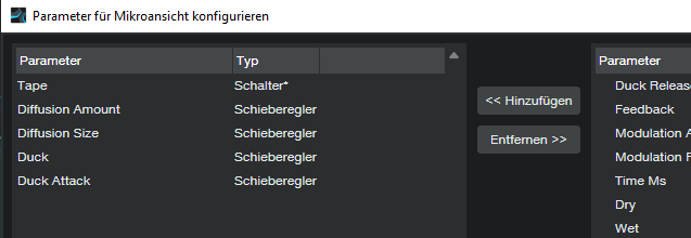

You're confusing the micro view with automation. The screenshot shows the micro view of some of the insert effects. You can configure any of these by right-clicking on any parameter in the micro view and from the context pop-up choosing "configure micro view parameter" (I only have the German version, wording might vary).
A window opens that shows used parameters on the left and the pool of possible parameters to add on the right. In the left part you will see 2 columns, "parameter" and "type". Hover over the parameter's type you wish to change and right-click. This allows you to change the type to "switch". Then close the window. I made a screenshot of me turning the "tape" parameter of a plugin into a switch.
But careful: This change will also be used in the automation track. It sets the automation value to hard 0 and 1.
