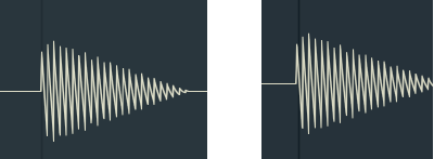

Postby billv » Wed Apr 17, 2013 9:15 am
Houston...we have a problem... do you read.....
Created a ruby midi test synth, stripped back to nothing.
Ran it for 3min at 1/4.
First picture at the start, the other at about 3min.
Not the same.
here's the test synth.
Ruby test_0.fsm
(34.93 KiB) Downloaded 1188 times
Required next step- test for 10/20 min- verify that the drift keeps stretching...
I'm pulling up stumps for the night, and taking a hot bath.
If someone else could verify that my test synth is not faulty,
would help me in making a confident next step in the right direction.

Postby billv » Thu Apr 18, 2013 7:37 am
nix wrote:I don't think streams drift at all Bill.
Ok. I'm not sure the stream test concept is any point here at the moment, cause I'm back to
trying to land one note, on the money, and failing.
here's the latest one, same test synth, this time went to 5 min exact.
First picture at start, the second after 5min
it's not accurate.Full stop.
My designs have been proven now, in-accurate, more than 4 times , using 3 different systems.
Sorry mate, But I'm back in the land of 99.9999% blah blah blah.....
billv
