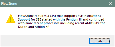

I just installed Flowstone and get the error when i try to use a DS(direct sound) control.
DS_GENERIC_ERROR
I have as sole sound interface a Steinberg UR12.
Windows 10
What could be the problem?
DS_GENERIC_ERROR
Windows 10

Installed setupFlowStone_3_0_8_1
Now getting error dialog
CPU is intel i7-7700 3.60GHz
Then error "Schematic load type not found"
and
"attempted to access past its end"
This is very annoying.
and
