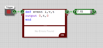

I was wondering if it's possible to get Ruby to automatically output time?
Here is the time,
but you need to get it with a trigger->
display time.fsm
(315 Bytes) Downloaded 980 times
display time.png (11.11 KiB) Viewed 9389 times

not sure if this is what you are after but it might give a pointer on self ticking! its a simple ruby time and date module!
rubytime.fsm
(740 Bytes) Downloaded 952 times
Best regards

Thanks Jay,
that's a cool example. I'm learning this some now.
Is there any other way than using 'input' & 'output' in the codebox?
I can use this function now a little,
as I have been trying to use the custom ticker without crashing my host.
Just wondering if that's pretty much the way to make it tick?
or is there another option?
