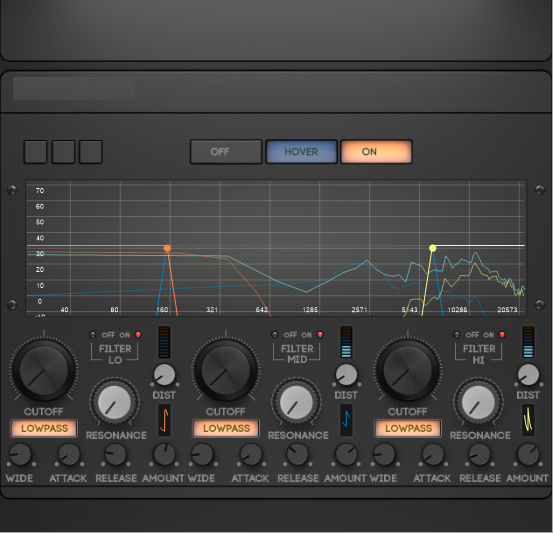

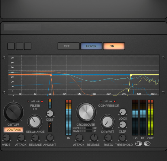

Indeed,Its a shame to do a fancy GUI and then have this windows dropdown.
I need this for the Filter selector window.
