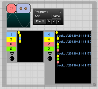

Okay, here is another spooky problem, it seems to be a bug. While trying to make backup system for "sensitive" modules that can cause crashes of FS app pretty often, I found that... I can't.
Here it is. Run teh schematic. Before you touch anything, important note:
Brown leds are of the same type, synced, to avoid misinterpretation here. They both are connected in the same order: first - backup system, second - load/reset shape. First led on the left - triggers shape loading(you can use provided example). Second brown led triggers "reset" which means that "default shape" is loaded. Both shapes are in folder. Third important element - on the preset manager, there is button/box named "b".
Concept. Because loading shapes in running application causes crashes, I decided to add a possibility to discretely save the preset in the background - before shape is loaded. Thus - if app crashes, I don't need to start from zero. So, if you click on whatever brown led (left or right), trigger goes first to manager and saves in the background the preset in relative "backup folder", and everything else happens next after that. The "b" box is for manual backup, without any dialog.
Do following.
1. Open schematic, don't load anything yet.
2. Open backup folder, to see when it works and when not.
3. Click the "b" box on preset manager. In backup folder new file emerges.
4. Click the right brown led (resets shape). In backup folder new file emerges.
5. Click the left brown led and cancel/esc the dialog. In backup folder new file emerges.
6. Click left brown led, and load whatever shape.
7. From that moment, if you repeat points 3-6, no backup file is saved. "Preset text file" receives triggers correctly, but does not saves anything, nor sends triggers (except for pt 8).
8. If you reload schematic - everything resets.
9. You can still save the preset from preset manager (which opens windows dialog box).
Triggers are monitored on brown leds and inside preset manager.

Not working here, tested on two separate machines. I played with the schematic in the state as attached above. When I load a shape via dialog box (left led) - the background savig goes dead. See the picture; even the control triggers are not sent from preset. The only difference between left and right led (because both load external shape files) is, that with left led, in order to load a shape - you must confirm the load via windows gui dialog box (and this confirmation - not the dialog box itself - seems to cause the problem).

With delay - not working. Even more - timer seems to be dependent on windows dialog box (i.e. in such case - background saving stops working also when left led is just clicked).

Major update.
This issue has to do with relative file paths in conjuction to comfirmation via windows dialog box (default shape loads from relative folder too).
If I switch the path into:
"X:\[folder-structure]\backup\filename.txt"
then it works as it should, but if the path is relative, like this:
"backup\filename.txt"
then it does not works.

Major update #2.
It looks that this issue exist generally in schematic mode.
Because it did not worked under FS, I did not do anything else. But few minutes ago - I just wanted to check something. It appears that exported exe (at least simple one; not tested under heavy load) works fine (not tested with VST yet), while schematic loaded to FS - not. Spooky...
I also checked the "start folder" primitive, which is confusing. In schematic mode it shows where plugin or exe will be exported (was exported last time), but it shows correct path of exe when starting that exe. Either it should give the ability, to show the folder where schematic is (to provide absolute paths), or they should fix relative paths issues.
