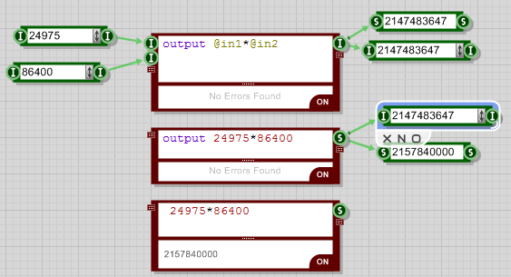

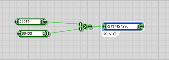

hi all cam anyone tell me why this int multiplication shows as a minus? im confused :lol:
and should it not come out as 2157840000
eh lol..png (8.7 KiB) Viewed 20733 times

At first, I thought it was a practical joke, or some guru math trick.....but
Confirmed.
+1. :?
And we can't get inside to fix it..... just send it to DSPR, with a note attached:WTF? :lol: :lol:

Looks like it has added the irresolvable 10000... to the minimum negative.
Like it has pushed it into a loop,
and restarted it's range from minimum.
Not the ie005 768 or whatever it does with floats.

Postby Jay » Fri Apr 26, 2013 11:42 am
ah so it is a little bug! lol i was thinking either my pc had gone wonky or my install had gone south!
tried the same in the ruby box and got these results which are even weirder! but it shows that it is the int system
eh lol 2.png (19.14 KiB) Viewed 20717 times

Postby Jay » Fri Apr 26, 2013 1:30 pm
yeh i know about that tester cheers! but it is no good for what i was doing! that gives a result of 2.15784e+009! it is fine as i was outputting it to a label anyway m8!
also it is not a bug, i understand now! it is the largest number an int32 is capable of!
