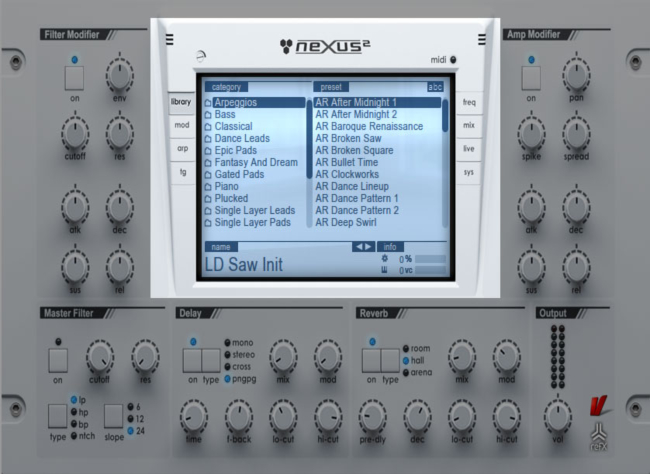

Is it possible to have a wave file loader with categories? And if yes, is there a way to do it similar in the example below? ( Instead of a drop down menu, the categories will be on the left and the presets on the right)
- Nexus preset manager.jpg (171.58 KiB) Viewed 11471 times

Yes. But of course there are several ways to do it. I created one of those ways, a year or more ago. But I can't remember in what thread it was. It could have been one from adamszabo or Spogg. (I moved to 3 different PCs in that time, unwanted. So lost a lot of schematics)

Ahh that sucks. I guess i will have a look around and see what i can find. I wanna attempt to make my own but i have no knowledge on how to create a manager. I seen a post about the same kind of manager a while back, but nothing ever came about it i guess.

Maybe this can help you get started. It is a file reader that creates a hierarchical tree list of a folder's content (recursively, so gets all sub folders and their content as well) and filters according to a file ending that you set (for example .txt or .wav)
This example uses a droplist to present the result, but this isn't necessary. The Ruby class creates a csv that follows the conventions of a menu string ('<<' and '>>' to enclose contents of a subfolder). You could alter this method to spit out just the content of a selected folder instead.
Please read the whole thread, as I didn't explain the intended usage, before Spogg asked for it. The details therefore are only found in the thread, not the schematic. Spogg uses this system successfully in a few of his synths to date, so it shouldn't be too difficult to understand in terms of Ruby.

Yeah im still a noob at this. Would it be possible to take an existing preset manager that already has categories and replace the "text file" module with a wav array or wave file module?
