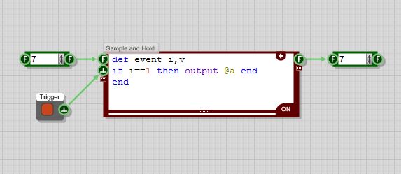

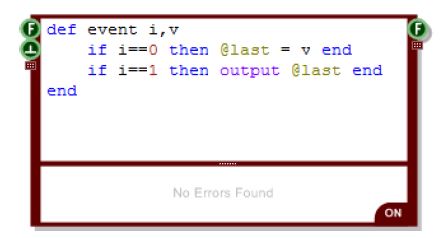

Hi again!
This is the Ruby Sample and Hold found in the User Guide of FS (page 143):
And this is a simplification that I made:
It works fine here... what do you think about? Any risk to use it?
