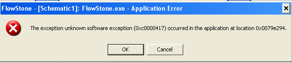

This morning i woke up and opened fs...then open schematic..
added a afterload and s+hold to make sure a value was there on exe start up...
Exe started fine...anyway...back to fs... re-load shematic..
schematic is dead...can't get in....
(this is 2nd time now, in two months, same issue)

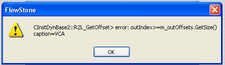

During initializatioI get this...

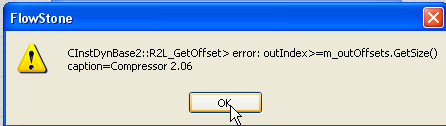

Click it then get this...
I'm accepting that this f##kup is my error, the 'compressor' is mentioned,
the afterload i put it effecting preset ....so I'm thinking that's the cause some how
My Question is, is there a way in to this schematic???? :?:

Postby MyCo » Sun Sep 08, 2013 9:11 am
Here is a registry hack you can try.
1. Close FS
2. Extract the attached ZIP somewhere
3. Double click "FS No Autostart Audio.reg"
4. Open your schematic
If this works, fix your schematic and save it.
You can leave this hack active or double click "FS Autostart Audio.reg" when FS is closed, to remove the hack.
FS Reg Hacks (MyCo).zip
(609 Bytes) Downloaded 842 times

Postby billv » Sun Sep 08, 2013 10:17 am
Thanks Myco....
Just had first go...or 6...still no go...
here at
MyCo wrote:3. Double click "FS No Autostart Audio.reg"
I get default FS Pop up crash report window...and no FS
then
MyCo wrote:4. Open your schematic
..still same results as first post..
back to the double click...i go again...crash...but with 'safe start option'
so I try open schematic again...still no go...
still mucking around with it..... :?
I think i've killed it... :shock: :lol:
