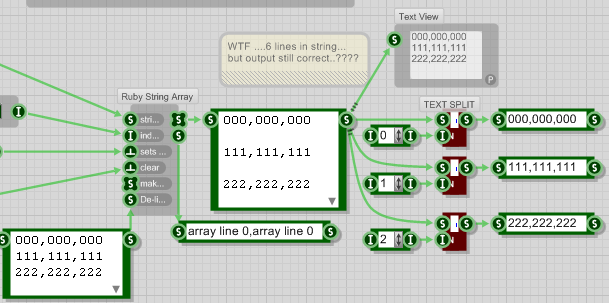

It's this little section here that's causing the problem...
There are different standards for indicating the end of a line. Sometimes it is just "\n" (new-line), sometimes just "\r" (carriage return") - but the standard in Windows is to use both; "\r\n", and this is what the output from string prim's uses.
So, when you split at the "\n", it is leaving the "\r" at the end of each string.
But now it gets really weird.
When displaying its GUI the string primitive only looks out for "\r" and ignores "\n" - so in this case the extra "\r" is treated as extra new line. OTOH, the 'text display' module (using MGUI) only treats "\n" as a new line and ignores "\r", so no 'extra line'
Here's a little schematic that shows the problem...
So we have "\r\n" at prim' outputs (and the Windows standard), "\r" for string 'property' display, and '\n' for "MGUI" string display
Bug ? - hmmm, I'm not sure, but it would be damned weird to design it so inconsistently on purpose!!

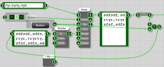

The problem that you started out with - the array not updating - could have a simpler solution. I'm not totally sure without looking at the original, but there's a known problem when feeding string arrays from file/preset data.
Very often, the cure is just to insert a string primitive just before the 'set array' input of the sting array primitive - very often that seems to 'rebuild' the string formatting so that it gets read correctly.
Now that I think of it, maybe this odd "inconsistent line terminator" thing is what causes that problem?

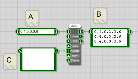

The problem is the way I've put every preset value into a slot(comma's).
The FS String array does not deliver here...
If I input strings like 'A'....'B cannot be routed back into 'C' so the array updates...

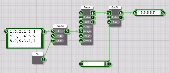

You can do it using the "String to string array" and "New Line" primitives - I think even with that extra stage, it would be faster than the Ruby, certainly for all the other more commonly used inputs.
Re: Ruby String Array
trogluddite wrote:You can do it using the "String to string array" and "New Line" primitives
Awesome...
- ScreenShot291.png (33.21 KiB) Viewed 20761 times
