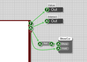

why not using the show cursor primitive? you can set "hold position while dragging"
Re: MouseCursor Position
Nubeat7 wrote: "hold position
Thanks Nubeat7....didn't notice that...

Nubeat7 wrote:why not using the show cursor primitive? you can set "hold position while dragging"
Ah! I didn't get this right away...
