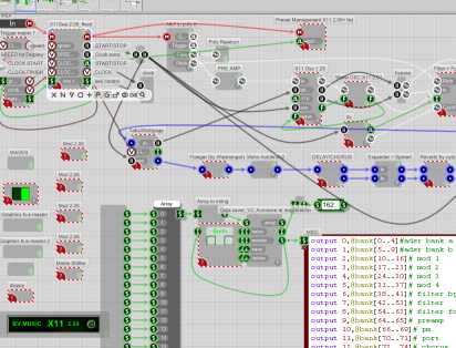

I've never seen 'a ruby companant shutdown' happen this bad....
While inside main fsm, i added a bad loop...
about 80% of all ruby componants in entire fsm were turned off for excessive processing.
Thought I'd mention it in case there were more noobs out there playing with loops..
Practice loops in isolation....

A "global" reset for the Ruby prim's would be nice though. If you know what bit of code just made the problem, it's often very quick to fix, but going through all of the modules to reset them is really time-consuming.
Re: bad Loop causes massive ruby shutdown
trogluddite wrote:going through all of the modules to reset them is really time-consuming.
they were all frozen...couldn't re-open...
brought in new ruby module and tried to capture offending code for reference...froze as well..
I think maybe if i removed all module links..may have unfozen it...
but didn't try...schematic too big...just bailed out...
should have saved it under alt name to re-investigate....

What about an 'display' in debug window, that shows how much processing
your code is using.....
It's like tester mentioned in other post, it's really hard, being a noob to ruby, to
understand fully what's going on....
Here's a good example of what i mean...
This fist loop runs in about "a blink of an eye'..
In th 2nd copy, I've made 1 change, adding a control variable,
And now it takes a full 2 sec to process....
Point is....
It looks like you need "solid" coding skills and "understanding" to get the best out of ruby.
Not knowing stuff like this is making my current project run at 3 times the normal cpu cost....
It's becoming more clear to me that trying to improve my project using ruby is almost pointless..
When i put my current project version up against a older green version.....
the evidence is frightening
....and just keeps piling up......
Green versions run as smooth as butter...current version is like f##king sandpaper....
A million green prims run smoother than a few thousand rubies....
And tester thinks "he's " fustrated....
I'm so close to shutting down and going back to making albums....it's not funny...
