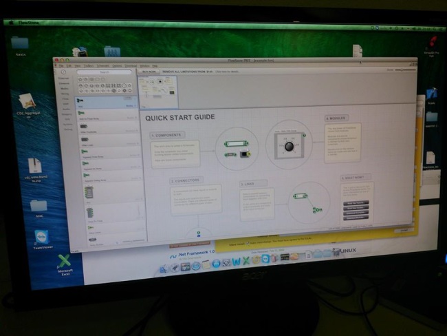

Well this is on of those Topics that might be hated by mac-haters.
Well i'm a 'little' hater too but there are users there outside that are let me say 'only able to work on mac'
So this Pic will get you up - and NO - this is no fake!!!
This is FlowStone Free runing on an OSX 10.8.5 powered with Winebottler:
(App gets arround 700mb :P)
Well - I have to say - it run for eaven 10 seconds before it crashed ^^
BUT:
I think i just got some settings wrong that are forced in WineTrick - WineTrick lets you Import libs from Windows example MS-Framework - some dialogs - AND GDX+ (called gdxplus)
I found out that FlowStone will Need GDX+ and the standart Windows Fonts otherwise the Programm Looks like a cutted peace of paper.
So my Goal is NOT to get the whole FlowStone to Mac - and NOT VST to AU!!!I want to get exported EXEs to mac-users.
And for that i Need to know some Basics:
What modules of Windows are used by FlowStone or FlowStone exported EXEs?
Example those i could get loaded:
GDX+ for Graphics
DirectSound for Sound
Force Sound to CoreAudio
But ther must be some more - because ruby is crashing all the time and i mostly could get it working for only 2 minutes
Shure! I'll post results if all is finished - Because this might be interesting for mac users ;)
Regards
C.Hackl

Well got some news:
Winetricks Settings: (check all those elements listed here)
Code: Select all
cmd
dinput
directmusic
directplay
dmsynth
dxdiagn
dsound
gdiplus
hid
mfc40
msscript
vcrun6
mfc42
msvcirt
vcrun6sp6
vcrun2003
vcrun2005
vcrun2008
vcrun2010
windowscodeccomponent
xinput
consolas
corefonts
lucidia
tahoma
ddr=gdi
sound=coreaudio
win7
Here is the link to the Winebottler Project:
http://winebottler.kronenberg.org/
Issiues:
Startup error - but "normal" environment for FlowStone
Bitmaps are everytime NIL or NULL - they are not loaded correct - some dll is missig here tht i could not find
Audio is verry laggy with clicking noises
Wine is not starting a virtualWindows - it is emulating an Environment - so the FlowStone.app will get about 660 Mbyte when the built is finished.... I know i may have loaded to much now - i just wanted to check it.
Any more Ideas here?
May a mail to the dev make more sence here?

Postby chackl » Tue Nov 05, 2013 11:53 pm
Well it does not make any sence until FlowStone it self does not run :P
I told i'll do no port - This means i'm not trying to get it stable after everything is working. But if FlowStone it self will be able to execute all things that (like now load and draw Bitmaps) - the exported exe files will be no Problem.
So i did not try but i may gues whats hapens on mac with the current things:
If you have the Pic as Ruby load it may shut down al ruby components inside
The load time is verry Long now on Windows - Load times will dublicate on mac
And i'll write you a pn back ;)

Postby chackl » Wed Nov 06, 2013 1:15 am
Nubeat7 wrote:
chackl wrote:But if FlowStone it self will be able to execute all things that (like now load and draw Bitmaps) - the exported exe files will be no Problem.
you really think that exe export would be possible? do you mean executables for mac? arent they called different
what about ruby will it work?
Well i think this may take a while :D - I've done plugins vor VirtualDJ on Mac and..... dont talk about it ^^
So if you Need a quick solution - here we go :D
Well i tested it now and it seems to work for some simple operations.
The joke:
If you load a file with the filedialog (coming from Winebottler - so the Dialog is like on mac) - You'll see parts your mac System. so some path Parameters E.G Documents or Desctop bekome mac equivalent and will take the Folders of mac. The mac System Folder is not accessable.
Belonging Ruby - when i integrated the VC2008 packs ruby was runing normal.
Only Problem at the Moment: No Bitmaps - None!!! - Not loadable.
Ther is some lib that FlowStone is using from Windows that i did not find and i hope some head here knows something about that.
EDIT Just noticed that the common dialogs are not updating the string. I make some tests tomorow.
