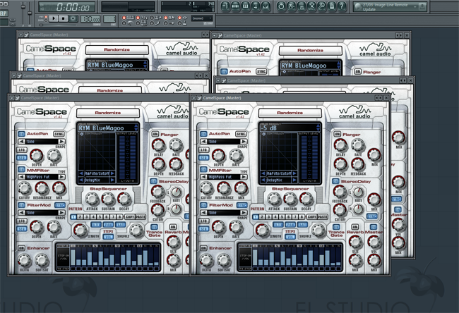

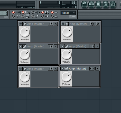

Re: Bad idle CPU consuption
Amp x 6 : 5%
Camel Audio Camel Space x 6: 2%
Im running Intel Core i7 3770k, win 8.1 PRO 64bit.
- camel space.PNG (506.04 KiB) Viewed 16922 times

Chamelspace just disables the audio processing, when there is silence for some seconds on the input... as soon as you put something through, the CPU shoots up and stays there... after some seconds it goes down to idle mode.
This has nothing to do with FS, the chamelspace devs just wanted to squeeze out any tiny bit of CPU. You can build that into a FS Schematic as well, just don't use the standard "always processing" method.
