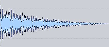

I have a problem to solve. If I have a beating sound, made of 2-4 FFT (sine like) components (= slightly irregular envelope, beating speeds unknown) that fades out (not linearly) - I'd like to draw (measure) a curve that follows peak (or average? or peak?) values of that fade out.
Sometimes the beating sound may be made of 2 FFT components, producing 0.2Hz beating. So - how to approach it, to get theoretical curve points in selected points of time? Some sort of envelope follower? Some sort of FFT band recalculation at some sort of resolution?
Martin? KG?
Martin? KG?
- curve.png (21.71 KiB) Viewed 18120 times

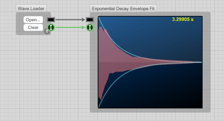

You might try to model your signal as exponentially decaying and fit the time constant. Here is a schematic that may serve as a start. I adopted KG's idea of analyzing the wave file in reverse order, searching for peaks which are greater than previous peaks. The resulting set of data points is used for a linear regression to determine the best exponential envelope fit. Hope it helps.
DecayFit.fsm- (1.39 MiB) Downloaded 966 times
- DecayFit.png (24.99 KiB) Viewed 17989 times
