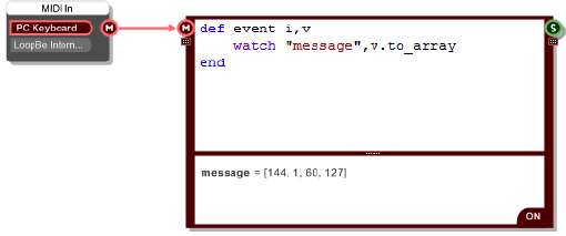

From User Guide,
ATM crashes repeatedly on 2 CPU's. Using PC Keyboard or controller.
I can't get any input without a crash, using a midi input on the ruby prim
no matter how i write it....very
Is this a new bug or what...?
def event i,v
watch "message",v.to_array

Seriously guys...I can't input red midi into ruby without instant crash.
Attach Trog's midi analizer to the midi in....crash..crash crash..
I can't get a result with this from the user guide.......
Can someone explain how to input red midi into ruby...?
(Problem is not in my midi set up,...I created a midi note in FS and same crash happens
if I send the red output into ruby)

And it's not something like [144,1,60,127]....
Its that funny looking number/string that I've seen a few times, like when
you loop a midi message, you don't get numbers like [144,1,60,127] in the watch window.
Know what I mean...sorry for the noob explanation.
