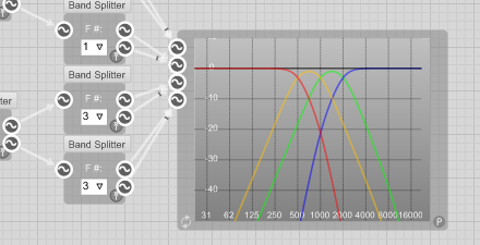

There was a good freq. Splitter in sybthmaker wiki. But it was limited by 3 bands..
I would like to make a splitter like that but with more bands (7) or make a simple eq.
What's best practice for make stuff like that? Where to get started?
I've had a look to the eq cookbook, but ive not understand so much of it.
Any hint?

Here is a 7 band splitter
viewtopic.php?f=4&t=2236#p10448
However, if you are after an EQ I'd suggest using peaking filters instead.

Hi, I have looked at the paper you provided for making three structure filters, but I was not able to understand it... Could you please explain how to calculate where to put allpass filters? I even tried to build 12 band splitter provided inside paper, but for some reason it didn't work well (I had phasing issues)...

Yes, the math notation in that paper is a bit formal.
I'll try to put together a (hopefully easier to digest) tutorial later.

Multi-Band Splitter Tutorial
Okay, here is my multi-band splitter tutorial. Please give me your feedback so I can improve it and put it up on FS Guru.

wow martin this is great! ...maybe adding phase/magnitude switch to the analyzer?

I have a nice multi band splitter GUI (not my old wiki one) I was going to share on FS Guru I might update the audio part to use this
