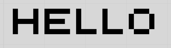

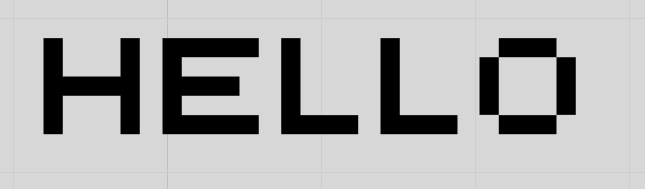

I created a pixel font, but found FS can't seem to render it correctly. It should be pixel-perfect, but it's blurry. Font size is set to 1, no alignment setting, style is "regular." It simply doesn't line up to pixels.
Not only is the placement of the text off but the spacing is too. So no hope of fixing it by setting x/y with area to float.
It should be exactly 1 pixel between each character. You can see it's a little wider.
This font renders perfectly in Photoshop, no problem.
Not expecting a fix for this, but I thought I would at least point it out. I'm not sure if this has any real effect on most other fonts. It is kind of a bummer though as it means I can't do what I was hoping to without rendering out all the characters and then writing a code to draw them all out.

In Ruby you can change the Font Rendering Method.
Use the method setTextRenderingHint with one of the follwing arguments:
"off"
"singleBitPerPixelGridFit" -try this
"singleBitPerPixel" -or this one for your font
"antiAliasGridFit" -I like this one for small font sizes and transparent background when using normal fonts
"antiAlias" -this is the default setting and looks very blurry
"clearTypeGridFit" -this usually looks best with normal fonts but doesn't work if the background is transparent
