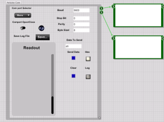

I am working on a OBDII Monitoring and Diagnostic schematic/module starting with just the com port module and some logging to experiment with. My set up is a Super-Mini ELM327 Bluetooth OBDII adapter for the car, a laptop with bluetooth and running Flowstone and Hyperterminal. I can connect and communicate with the OBDII adapter with the Hyperterminal and get back responses I would expect. I can connect to the OBDII adapter and sort of communicate using a com port module. However, it doesn't seem to behave as I would expect. First, it was my understanding that the ELM327 communicates utilizing ASCII. However, with the Flowstone com port, I have to have Hex set to true for any communication to work. Also I thought the RXTerminator should be a <CR> (13) but only works with a line feed (10). Also when I send standard "A" ELM327 commands (ATZ, ATI, etc.) I get back a Hex response as I would expect. But when I try a PID command (0101, 101c, etc.), I do not get back a response.
I got the idea for this project from the DSPRobotics Blog here: http://dsprobotics.blogspot.com/2011/09 ... stics.html However, they give little info/details. I have the ELM327 manual, have researched on the internet but can't seem to solve this issue. I thought I had an understanding of the com port module but maybe not. Ultimately I would like to create a software tool Like ScanTool or Torque for realtime monitoring and diagnostics of the vehicle parameters (fuel, RPMs, speed, OX sensr, etc.).
I have attached the fsm. Can't attach a copy of the log generated from it. But here is a portion of it:

If anyone has any thoughts or suggestions, I would greatly appreciate it.

if you use the setting "Hex" with true,
your message must be in hex format,
from your log it seems that you are sending it as a string.
and the preparation command ATSP0 return nothing, not OK, so it can't read.
however, here I found a datashet for the chip and protocol.
http://elmelectronics.com/DSheets/ELM327DS.pdf
and it would seem that the LineFeed can be enabled or disabled, or change the character assigned.

Thanks Tronic,
As I mentioned in my original post, I already had the ELM327 manual that you referenced. But your comments prompted me to try some things:
I tried adding a string to ASCII module in-between the text box input and the data connector on the com port. Then tried several different combinations of turning hex on/off, null to true/false but that did not work.
Then I tried the string to Hex module same combinations but also did not work. The only time I can receive back data is when I send a string only with the Hex on the com port set to true. I can connect to the ELM327 adapter but don't seem to have something set up properly.
Hyperterminal readout demonstrates that I can talk to the ELM327 and I have used the android phone app "Torque" (free version) and was able to pull up all the vehicle parameters so I know there is not an issue with the ELM 327 adapter or the Bluetooth connection.
Again, thanks for the suggestions Tronic. I will continue working on it.

I think you can send strings directly, you do not need the hex mode,
and I think you forgot to add the line-end character to your messages.
however, I have attached the schematic, and a link to arduino implementation.
https://code.google.com/p/opengauge/sou ... bduino.pde

Tronic you are a Genius!
I stripped down the com port tester to its bare bones to eliminate any issues with the logging modules, added the integer module and ascii to string module as you suggested, set RXTerminator and control character in the interger module to 13 for <CR>,and Wha La! I was able to get back the same responses as the hyperterminal gave (see export below). IT WORKS! Woo Hoo! I had been working on this for a couple of weeks and getting no where till your help. Thank you so much.
Now I have to develop the complete communication to get the PID output, apply the math to convert to the hex output to float values then use the float values to drive gauges and dials to indicate the car parameters. Your link to the arduino project will help greatly with this.
