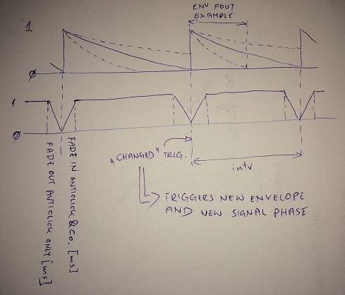

Re: How to eliminate 'click' problem?
...Let's start from scratch...
Sorry for confusions.
p.s.: I'm not sure how the phase change point truly relates to "changed" trig. Maybe that's the issue?
Yes, this is almost what my schematic does. Only problem is, that you need lookahead to "de-click" the decay envelope by fade out. In my schematic this is done by delaying the trigger/pulse that starts new envelope and re-triggers phase and uses the original (non-delayed) pulse to trigger the fade-out.
As long as you will keep the same delay (=fadeout length) on all oscillators, their phase relationship will remain the same.
The Fade-in part is done by an envelope follower (lowpass filter) on the original envelope. This sort of adds "attack" to the envelope (effectively creating AD - attack-decay envelope). You can see this in my schematic by pausing the scope just in right time to see the envelope transitions.
