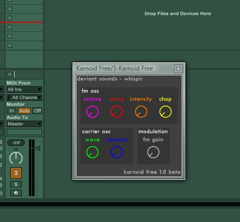

I'm developing a VSTi. The font used for everything is Futura. Computers that do not have Futura will not display the text, thus leaving knobs without labels.
Is there a way to include a font within the VSTi, or do I have to bake everything to a bitmap?
EDIT: Here's pictures of the issue. The first is the VSTi working properly on a computer with the font, and the second is a test computer without the font installed.

"Font" primitive has input node called "alternative typefaces". Adding there something like arial or else present by default in the system - should help (though - never tested - check what manuals write about it).
Another way is to use bitmaps with texts on it instead this.
Re: Text won't appear if user does not have font
Baking it in is generally the best way if you can, but otherwise you'd have to create a Windows installer that installs the font along with the plugin.
