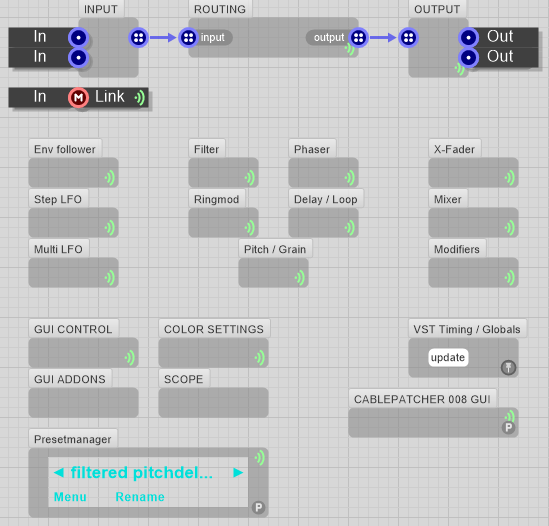

one way i use to avoid deep nesting is, using ruby, 1 code component really can save several green levels..
i also extract all GUI elements from the stream parts so that they are not placed somewhere in the 5th level of some stream modules and you need to go another 5 levels down to change some behaviour of your knob..
the deepest levels in my schematics are normally max 5 levels deep - specially on more complex GUI controls - the stream related modules rarely are deeper than 3 levels anyway...
here for example you can see the first level (directly below the surface) of bondage, from here you can go maximum 4 levels down
about deletion of unused things, sure everything which is not needed should get deleted, also float, integer,or string prims which are through positions (which have an input) are senseless, often its needed in the development phase to control values but all the "watch" elements should get deleted in the release versions, normally it doesn't or shouldn't affect the performance but the size and the loading times, same goes for help texts or info panels which are seen just in FS (use purgeable for things which shouldn't get deleted but not needed)
