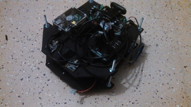

Yes I did. I ended up using a Raspberry Pi configured with the Phidget Webservice running on it. I was able to run all of my Phidget boards wirelessly this way with the exception of the GPS board. For some reason, it would crash the webservice, while everything else ran fine.
Phidget's website has a walkthrough on how to configure a Debian linux install with the webservice and Phidget libraries you need to put on the Pi. I dug elsewhere to get the wireless dongle up and running on the Pi, there are plenty of Raspberry Pi tutorials on that also.
I was able to drive a little robot car I put together with this, its all phidget based mostly, from Flowstone. I didn't make any kind if a fancy GUI, but just enough to run it using the Xbox 360 controller. I have attached the flowstone code if you are interested. It was just something I was playing around with, but hopefully you'll be able to use some of it.

- IMG_20130706_113012_720_small.jpg (194.81 KiB) Viewed 21317 times
