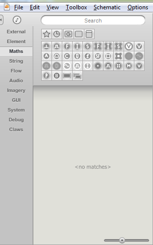

Hello,
In my overview the tag filters are emtpy.
how can i reset it?
how can i reset it?
- tags
- tags.png (22.03 KiB) Viewed 10362 times

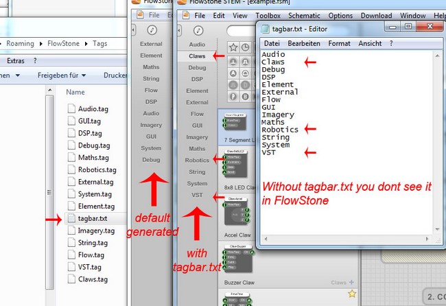

i have writen a little cmd batch tool.
this will generate the tagbar.txt which would not generated automatical.
the problem:
some times FlowStone lost the information for the given tags in the AppData\Roaming\FlowStone\Tags folder.
If you delete the Tags folder, FlowStone create it automatical after open and close of FlowStone.
But it does not generate the tagbar.txt file which is needet for displaying it in FlowStone.
If you create new Tags you have to save the configuration before deleting the Tags folder.
In my example its the Claw.tag
So save the claw.tag
delete the tag folder
start FlowStone and close it
Now copy the saved tags back to the Tag directory
After this you have to start the tag-create.bat file.
This will generate the tagbar.txt in the tag folder.
After starting flow stone you will now see all availible tags
As you see the tags now sorted alphabetical
Thanks for help!
the problem:
- compare
- tagbar_small.jpg (91.5 KiB) Viewed 10326 times
