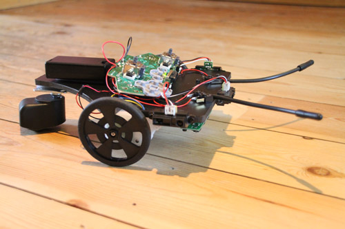

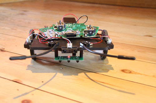

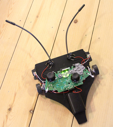

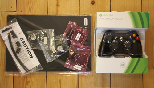

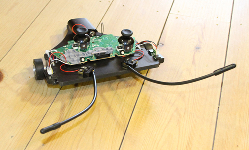

The bits arrived this morning for the XBug!
Here's the finished thing:
No had chance to test it yet with FlowStone as I'm waiting for the Xbox receiver (I thought it was Blue Tooth but it's not).

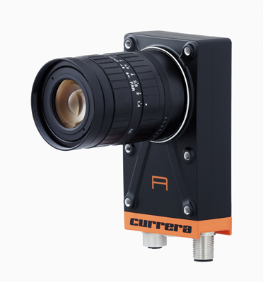

What would be really cool for your project is the new Ximea CURRERA-R camera with built in embedded PC:
Yes this is a hires camera with a windows embedded PC built in, now supported by FlowStone
Also I managed to test my XBug today, it needed different motors and wheels but now works a treat!
I've had it roving around the kitchen autonomously and also line following - cool
