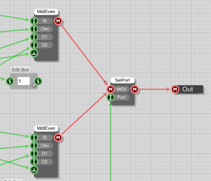

Is there a way (in this case) to always output the MIDI (in the upper part) before the MIDI in the lower part?
I need priority on execution here due to the application I'm making. Is there any MIDI delay?

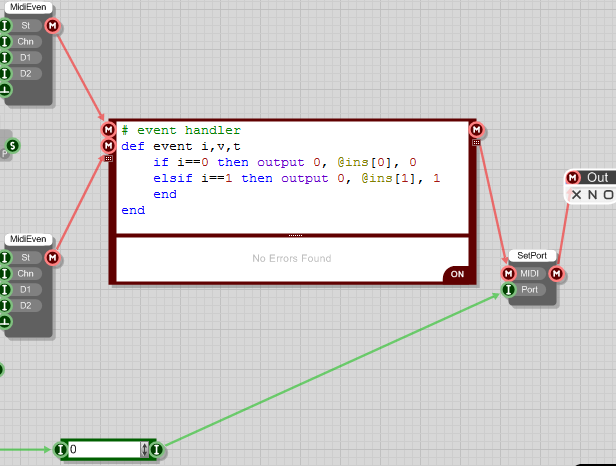

Well, this is what I've done with Ruby:
not sure how much consistency this code will be, but seems to works.
How is managed the output time and @ins array? Are unique for each event handler? Or can they mess each others?

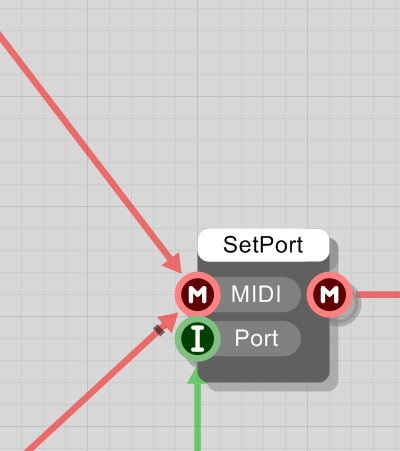

tiffy wrote:Did you try to change the "link Order" of the two Midi Inputs on the "setPort" primitive?
Uhm, how can I do it? Order on the links?
- Nowhk
- Posts: 275
deleted by uploader
deleted
tiffy - Posts: 400
Re: Setup priority on MIDI Execution - Delay?
tiffy wrote:The easiest is to connect the top link first and then the bottom link or alternatively hover mouse on the left side "M" of the setPort primitive and left click on it once only. You will see the marker flip to the lower Midi link.
In this way?
Nothing change. The upper part is trigger later
tiffy wrote:Yes.
I want the upper part triggered before
tiffy wrote:But if this doesn't work then I cannot help you any further as I never worked with Midi.
No matter, thank you for the help anyway
Any Flowstone/DSP master can tell me if my Ruby approch is ok? I don't know in deep how pins/events/time/arrays are processed, honestly.

In the code you have written,
it doesn't actually delay the second one I think.
It allows the signal to pass through without change.

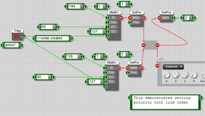

Here is a demo of the link order setting priority->
The links out of the button set the order.
Will be back with the delay ones soon.
