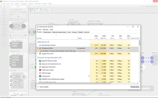

my question: ¿ how can i make up an interrupted job ? ¿ Is there a place where the file changes are saved? ¿ Any recovery file :cry: ?
FS 3.0.6
2021-01-03 22_31_20-.jpg (54.72 KiB) Viewed 16652 times
I think it happened due to the excessive consumption of Ram memory
because FS 3.0.6 was working perfectly

ErvSoft wrote:¿ Is there a place where the file changes are saved? ¿ Any recovery file :cry: ?
In "Options -> Application" you can enable and choose a time interval for auto-saving the current work-in-progress. In the same menu there is a button to open the folder where the recovery files are stored (usually inside the current user's AppData/Roaming folder).

Postby ErvSoft » Fri Jan 22, 2021 5:05 am
Thank you guys very much, sorry to revive the thread hahaha
if the mouse is really strange, but in computing, almost everything is possible,
So far after the Windows 10 update I did, in addition to reinstalling all versions of Microsoft Visual C ++, FS 3.0.6 is going great, fluid like water, anyway I already made the habit of saving each 3 minutes :lol:
I had to elaborate all over again one part of a scheme, sometimes it is a funny trauma,
I made a shortcut of the recovery directory, with this I stay relieved :)
