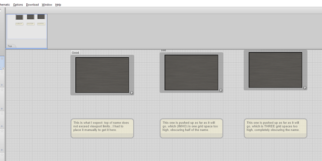

I'd noticed several times that when I opened some schematics from the forum, modules/primitives were pushed up beyond the top border of the viewport, even if the viewport is moved as high up on the schematic as it will go. Here's a capture to illustrate:
The three modules are copies, only the names changed. Here's the schematic to play around with:
Align.fsm
(94.79 KiB) Downloaded 813 times
There appears to be a correlation with where the mouse cursor is relative to the object when you start dragging it to move it...sometimes you can drrive the name completely off-screen, sometimes only halfway. (I verified that the problem, minor as it is, still exists in the current FS4 alpha.)

Spogg wrote:You know, after more than 6 years with FS I never noticed that!
I'll see your six and raise you another six! :lol:
I can't believe that I haven't done it by accident many times, especially back in my tiny-screen days; but it's obviously never battered down the door of my conscious awareness!
The "mouse correlation" is something to do with rounding the mouse's "y-delta" to grids, I think - it seems that strips one grid in height alternate between the full effect and only going half-way off.
