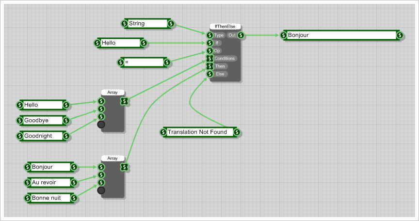

HI!
I'm new with flowstone and would need an example of using ifthenelse.
Thank´s

Postby Embedded » Wed Nov 23, 2011 5:49 pm
Try this:
If Then Else Translator clip.png (52.99 KiB) Viewed 15688 times
