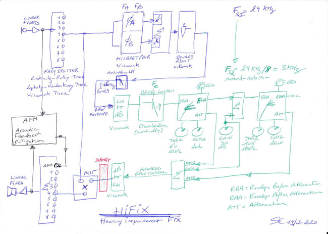

The attached sketches will help you decide if you want to be part of such project. Such project is indeed a open-source Hearing Impairment Fix, that's going to be duplicated in low voltage silicon, billions of times. It gets associated to a GUI and a fitting methodology, for quickly and scientifically setting up all the required parameters. The device is of course, embedding a high performance Acoustic Feedback Mitigation scheme. The aim is to ensure that the whole device remains open-source, and top-notch. This is mandatory for becoming a de-facto standard, allowing to decrease the time spent in fitting, allowing to maximize the customer and fitter satisfaction, allowing the reach a beautiful market share, allowing to constantly reinvest in R&D.
Please keep it simple, however not stupid. See the three introductory sketches. Click on them for developing them.

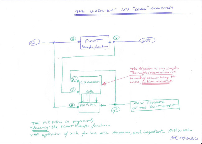

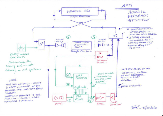

While checked my post, I realized that I deserve criticism about the way I am representing the Widrow-Hoff LMS machinery (the green stuff). The green stuff should be considered as a whole, kind of Flowstone component yet to be created.
The way I graphically represented the LMS machinery doesn't tell that the green "LMS Algorithm" subsection, requires the "X" signal (the plant input signal), like the green "FIR Filter" subsection is also requiring the "X" signal.
The way I graphically represented the LMS machinery doesn't tell that the green "LMS Algorithm" subsection is containing a "true Y, less estimated Y" block.
My current preoccupation is to streamline the required LMS machinery, considered as a whole, for it to become a Flowstone component easy to use, with a minimal amount of inputs and outputs, and no confusion.
I remain under the impression that a 64-tap LMS Machinery, hence a 64-tap FIR filter duly equipped with the required 64 accumulators, can render Flowstone, even more interesting.
In case somebody is wiling to see what a 64-tap LMS Machinery is capable of, and its convergence speed, I graphically designed one on LTspice, as analog schematic embedding analog delay lines. This is working, exactly like your brain. The LTspice schematic shows all the details that are required for transposing this as a x86 SSE routine. Worth noting is that IIR filters also work with analog delay lines. Let me know if you are interested.
Later on, there can be a "LMS Machinery II" that's exposing the above details, allowing more signals to enter the machinery. This way, at the condition that one is entering a 50 Hz or 60 Hz signal (power grid), into a "LMS Machinery II" component, comes the possibility to automatically reject such 50 Hz or 60 Hz signal, without any frequency, phase or selectivity adjustment, without any risk of drift thus, in order to make appear some useful signal that's buried, 90 dB below the perturbation.
Possibly nobody tried a Widrow-Hoff LMS machinery on Flowstone because of the physical audio input/output latency, when interfacing the real, analogic world.
Let's start, explaining the basics. You are certainly aware that a dual-channel FFT analyzer that's simultaneously computing the FFT of two channels, then "dividing" one FFT by the other for displaying a transfer function in gain and phase, is due to experience a difficulty when the two signals are heavily time-domain mis-aligned. Of course the phase diagram will exhibit a steep drop, but more surprisingly, the gain curve will get fuzzy, noisy. This is of course because one signal gets less related to the other, as soon as it escapes through time. A dual-channel FFT analyzer is not allowed to become a smart device, so smart it will search for the best correlation, and apply a delay on one of the two signals for restoring a perfect time alignment. How could such over-engineered "smart" FFT, issue a phase diagram one can trust? Impossible. The best you can do is to hook a correlator, telling by how much time, one signal appears to be delayed. This allows to apply a digital delay on the signal that's appearing "in advance". This way you get a super clean gain curve. And you get perfectly aware of the delay.
The Widrow-Hoff LMS machinery is by nature, immune against mis-aligned signals in time-domain. The LMS algorithm is robust enough, and its FIR filter can be made long enough, for coping with a "plant" that's embedding a delay.
The Widrow-Hoff LMS machinery generates in digital domain the "fair estimate of the parasitic acoustic leak signal".
Let's start with something, easy and simple. The "parasitic acoustic leak" can get implemented in digital domain, kind of simulation, using a 100 µs delay for a 3.4 cm distance, or a 200 µs delay for a 6.4 cm distance. One shall control the leak attenuation (say -40 dB to - 10 dB). One shall control the leak frequency response, kind of variable bass and treble shelving. Kind of Baxandall tone control. Or a 5-band equalizer. Or both. The hearing aid needs also to get implemented in digital domain, kind of simulation. All kinds of gains and frequency response are allowed. The hearing aid can embed all kinds of frequency bandssplitters, including the many ones that are causing a gigantic phase distortion. The transfer function and phase distortion of the hearing aid cannot in principle and by construction, ruin the LMS convergence, as the LMS machinery is only monitoring the parasitic acoustic leak transfer function, and never monitoring the hearing aid transfer function. This means that in principle and by construction, the LMS convergence can't get ruined by rapidly and constantly changing gains in the various frequency bands, speaking of a multichannel hearing aid. The sooner one can verify this on Flowstone, the best.
Finally, let's determine if a Flowstone LMS Machinery can deal with the real world. I mean, building some simple hardware consisting of a mike going into a analog pre-amplifier, possibly a tone control, then after, a power amplifier and a speaker. Of course this is going to howl, as soon as the amplifier gain is strong, and as soon as one is approaching the mike, close to the speaker. That's the idea. The PC that's running Flowstone and the LMS Machinery needs to sense a) the analog signal that's driving the power amplifier, and b) the analog signal that's delivered by the mike. Internally, in digital domain, the LMS machinery elaborates the Y "copy" signal, qualified as "fair estimate of the parasitic acoustic leak signal". Everything is perfect till here. The fatal issue comes now. For the Acoustic Feedback Mitigation to work, one must convert such digital signal into analog. This causes a delay. The auxiliary "AFM" input (located after the mike), will get the anti-phase signal, much too late. Unfortunately, the LMS machinery being not a time machine, it can't "advance" the elaboration of the "fair estimate of the parasitic acoustic leak signal".The 10 ms to 50 ms delay caused by ASIO, USB and the DAC will ruin the phase of the annihilating signal. In case you have a better idea, please let me know. In theory, the total latency should be no more than one audio sample. Are there workarounds?
By the way, I've made an error in the HIFIX block diagram. Following such diagram dated 19/02-2020, the AFM input is at the output. I'll correct later on.You need to refer to the "AFM" block diagram. Over there you'll see how to enter the "fair estimate of the electronic version of the parasitic acoustic leak signal".
The "AFM" bloc diagram may look deterrent at first glance. The red elements are there, as helping hands for the LMS Machinery. There exist implementations, where one is counting on the LMS machinery, not only for learning the parasitic acoustic leak, but also for compensating the non-unity transfer functions of the speaker and the mike. You better don't encumber the LMS machinery with this. Try to stick to the original "contract" consisting of hiring a LMS Machinery, only for learning and cloning the parasitic acoustic leak. There is no free lunch. In case you encumber the LMS Machinery, you force it to dilute its capability, with what it is not intended for. It will behave poorly. Now that we are 100% digital, it costs almost nothing, to add the red elements. Using IIR Biquads, you can mimic or invert (reverse) the transfer function of the mike and the speakers you are relying on, far better than a 64-tap FIR filter (the LMS Machinery) that's incapable of handling resonant devices ... like mikes and speakers are ... that are featuring long impulse responses. Keep in mind that what I am writing here, only concerns a 100% digital simulation, that's not interfacing the real, analog world (major latency issue, see above).
