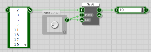

Hi Gang ... got a question on how to approach this.
Here's the issue.
I need to output specific output values [user defined] based on a Knob [0-1].
detail: There are 128 STEPs for the knob [MIDI spec]. For each value I need to plot to a table of values and display a STRING value [such as a Frequency or a +/- Gain value].
So, for MIDI value 1 will display 356. value 2 display 400, value 3 display 645 etc [just simple example].
The main question. I need to correlate 128 steps to a user defined string value [for display only]. What would be the most efficient way to do this ?
RUBY seems the most sensible ... maybe. Would I use CASE statement for this. That could get real messy with 128 different Cases ... it also seems it could get sluggish when polling the higher values ... don't know
How would You handle doing this ?? Without losing your mind in the process

Like this?
prmes.fsm- (7.42 KiB) Downloaded 851 times

Hello Martin ....
That's exactly it
That was the method [GetAt] I was just testing before checking back in. It seemed to scroll through the list smoothly.
Prior to that, I had started testing a RUBY example using CASE statements. That worked, but would be a lot of typing for this current project
It's still going to be a lot ... I've 8 knobs that each hold 12 unique configurations.
Thanks for confirming this approach BEFORE I got to deep into it.
