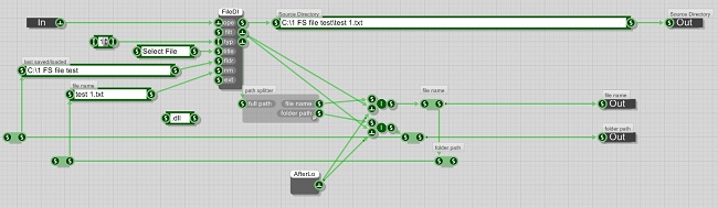

OK ... there must be something sooo simple that I've overlooked. I have tried many ways ... none of them work, at least not the way I need.
Sure ... if I only use a single module, to access a single location, the current schematic goes there. However, If I try to set up another module, doing the same thing, but locating to a different directory ... only the last location is gone to by BOTH separate modules. It's like they are sharing the same data, but they don't, and are not suppose to.
Here's a screen shot:
and the test schematic:
I'm only showing the single module that needs to have a set default [the last location loaded]. I NEED to have several of these [separate] that I can use to default locations.
Simply ... if working correctly, it should not matter how many default directory modules used in a project. Each module is separate and should work unto itself.

Remove the sample and hold section.

Hi
remove the direct Path splitter outputs back loop to the Path and filename...!
Then sample&hold the 1st selected and feed them to the other file dialogs as default?!

tulamide wrote:Remove the sample and hold section.
I ADDED the Sample/Hold section because it didn't work ... and still doesn't.
To be clear ... using the module by itself [only one directory] ... it does remember the location.
NOW ... duplicate the module. Now try to set up 2 different default locations.
The example being:
LOAD from a default location
SAVE to a different default location.
The 'Default' would be the Last location the User set with FileDialog selection.

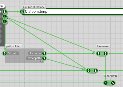

Re: Default Directory locations
OK ... here's the portion of the schematic that is suppose to assign a default location [based on the LAST used, separate/different for Load and Save]. In otherwords ... Load default will be different than Save default.
RJ I'm sorry, but your schematic works perfectly fine here. Exactly as you expect them to work according to your descriptions. Two default paths, one for loading, one for saving, it's always the last used one and it's always the correct one wether loading or saving.
