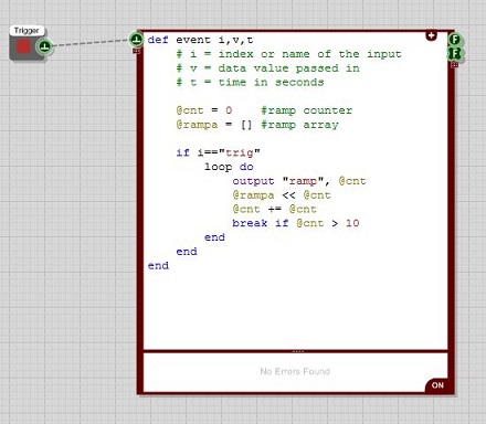

I need to make many random ramps that are slow, and was hoping I could do it in Ruby. I landed doing it in the DSP, but was wondering if slow waveforms can also be generated in Ruby as well ? ? ? And by slow I mean about 10 samples per second or so...
I forgot to save before I ran it - it crashed, but I took a screenshot

1. From the image I see it seems you what to generate a wavetable for a ramp.
#inputs should be named "length" (float) and "tick" (trigger)
def event(i,v,t)
if i=="tick"
output 0, (0...@length).map{|i|
i.to_f/@length

I entered the Ruby code and while it produces an output it is not a ramp. I am still working thru this... a few of the code lines do not make sense to me at all, but I AM NOT a Ruby coder, but I am learning.
The input 99 is a callback to the input for ???
Here is my code...
does this look correct? It just seems complex for something like an up counter, but again I am not a Ruby coder
