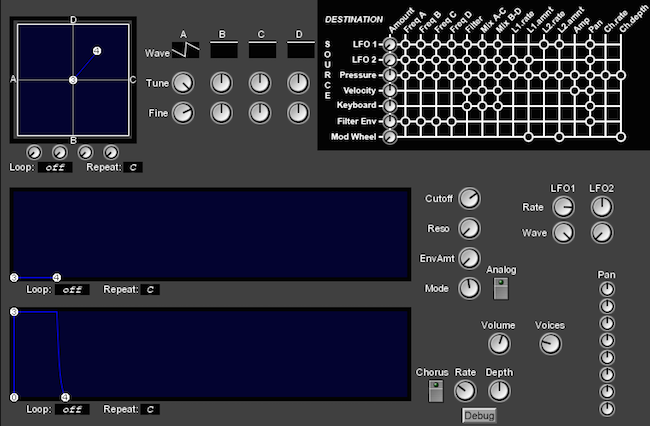

What I'm referring to is manual control of pan for the number of notes of polyphony. If your max poly is 12 notes, you'd have 12 pan knobs; one for each note of polyphony. As I understand it, the first knob sets pan for first key pressed, second one for second key pressed and so on. So it isn't based on the keyboard position, just sequence in which the keys are pressed. Many early digital hardware synths could do this, the Prophet VS, for example. If you look at this screenshot of the plugin, Augur - which models the VS quite accurately, you see a stack of knobs at the lower right marked 'Pan'. There are eight because the VS had 8-note polyphony. I assume if you press just one key, it's panned to the position set by the top knob, the second additional key pressed pans to the position of the second knob and so on.
