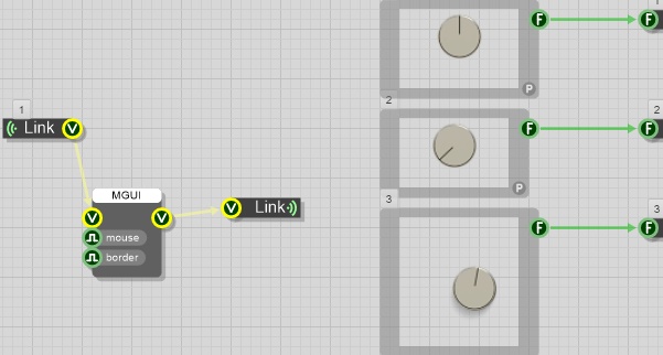

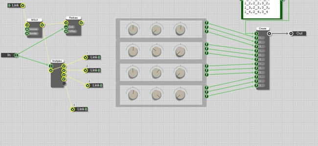

1. Switching panels is easy, use a multiplex with a wireless link into each module.
Then place a wireless into each module that you want to switch, taking care to name them either sequentially or use unique names for each one.

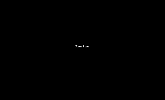

As for GUI scaling , I collaborated with Sampleson on the B3 and yes its made with HISE .
What I did was I made the gui in the maximum allowed size , (Retina) and then HISE allows for the resizing.
In FS you can do the same , either using this configuration BUT this might only be possible in the 64 bit Alpha , which I recommend anyways. Or , upcoming in the alpha for VST3 is just dragging a corner of the gui to resize.
64 Bit alpha.
I would upload examples but I am using the alpha , let me know if you are using the alpha and I will upload.
64 Bit alpha.

@lalalandsynth - that scaling was pretty slick, thanks for showing that capability.

Sure, will do
lalalandsynth - Posts: 600
Re: General Functionality Questions
Here is a resize thingy.
Simple Gui Switch
