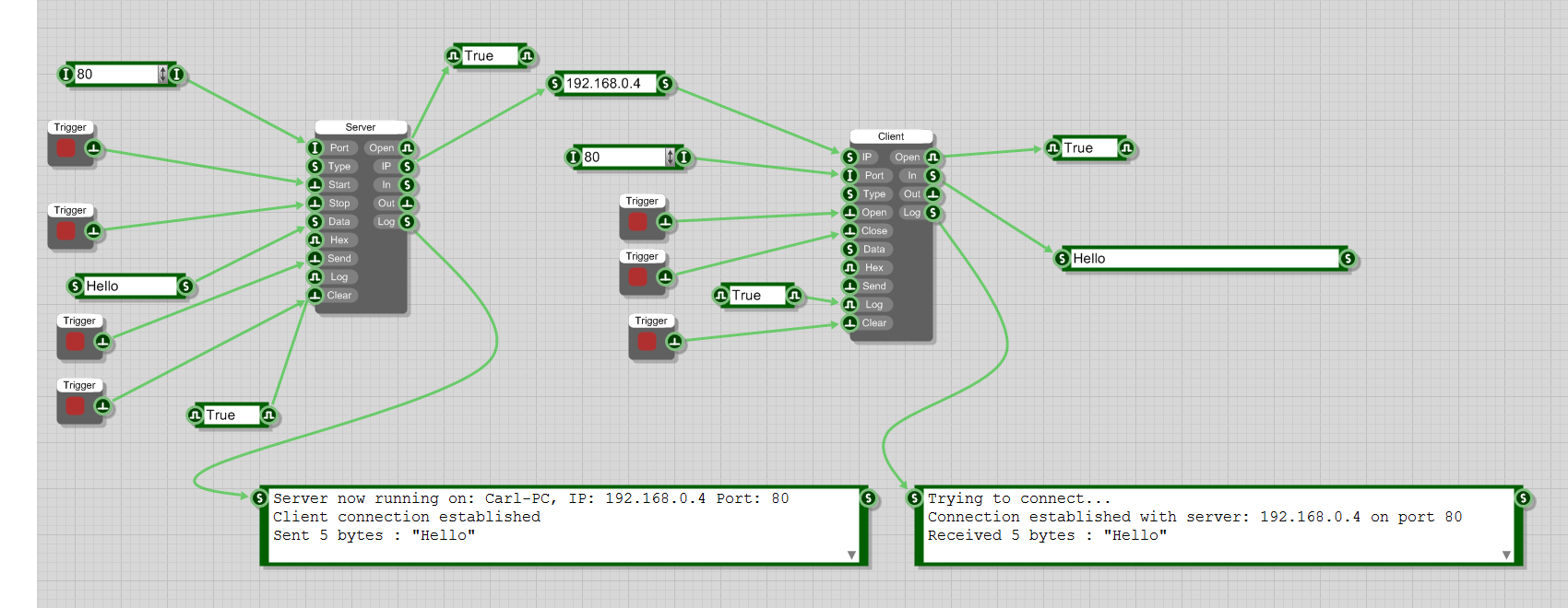

Here's a working example that sends data to and from the same PC to test the networking.
1) Start the Server
2) Open the Client
3) Send data from Server
1) Start the Server
2) Open the Client
New Network Test.fsm- (428 Bytes) Downloaded 1233 times

If it can't connect then the port could be blocked or being used by something else?
Try some different port numbers (eg. 1000), this works here but you may have to open the port in your router.
Does the Server start ok (must be started first)?
Here's what it looks like here :
