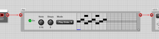

Here's an example we've been working on for an arpeggiator module.
To stay accurate all the timing critical stuff needs to be kept within a Ruby section. So that's inside a Ruby component or passed via Ruby Value or MIDI connectors. As soon as you convert back into triggered data you'll lose accuracy.
- arp.png (16.42 KiB) Viewed 23051 times

support wrote:To stay accurate all the timing critical stuff needs to be kept within a Ruby section. So that's inside a Ruby component or passed via Ruby Value or MIDI connectors. As soon as you convert back into triggered data you'll lose accuracy.
Thanks! That is nice to know because i thought this would be possible. Well then i have to get up my ruby skills
