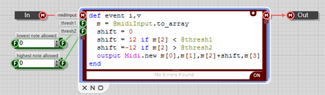

Hi Andreas,
I'm too busy 2... but maybe this little gem from nubeat7 gives u a hint:
or this: http://www.dsprobotics.com/support/viewtopic.php?f=3&t=3294&p=17614#p17605
- midi note manipulation by nubeat7.png (34.36 KiB) Viewed 18235 times

I think this is a keyboard split right?

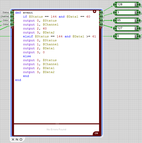

Ok I think some programmers here will call me crazy x) but after a few days of googling I found that "priority queue" thing and the way I did it works but is totally buggy and I think there gotta be a much easier way.^^
Hope you can help me
Priority_Queue.fsm- (3.16 KiB) Downloaded 899 times
