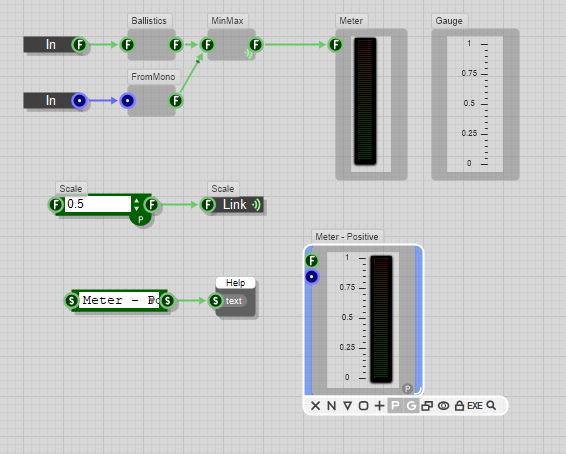

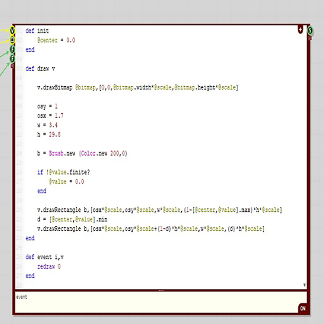

How to make the stock meter Db stay horizontal? Is it through Ruby settings? Which command lines do I have to change? Or is it impossible to do that?

I've never tried to "draw" things in Ruby, but I'm going to guess that if you switch the values for width and height, you will have yourself a horizontal slider.

Mr Duckett, I tried, I was changing and replacing values in Ruby and experimenting ... the meter almost became a spaceship and nothing to mark the movement horizontally ...
